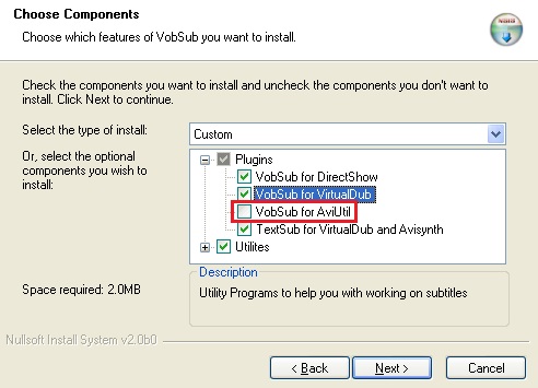

Answered By 20 points N/A #197645
VirtualDub Error Cannot load plug-in module
The problem might be because when you install the VobSub software you selected full installation, which actually included the AviUtil plugin. To resolve the error you are encountering:
1. Reinstall VobSub.
2. During the setup, select Custom from the Type of Installation drop-down box.
3. On the list below it, uncheck the box beside the VobSub for AviUtil.
4. Continue the installation until finished.
Try to run the program again and check if the error is gone.
