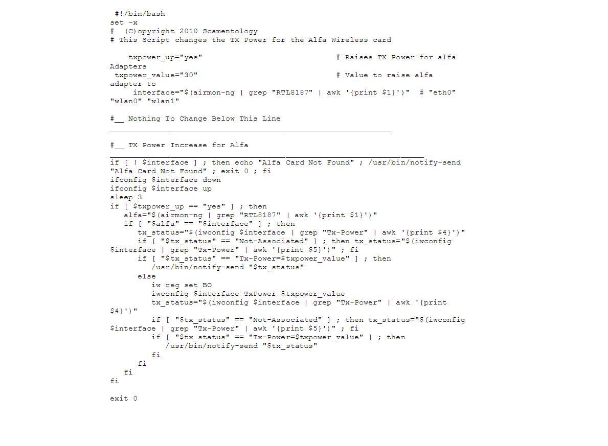

Please see the script in the attached text file which will change the TX value of your Alfa Card. This is not exactly what you want but you will surely find this useful. You can put this code in a whatever.sh file:
Hi Mary Drapper,
Making changes to the script is a difficult job, so please be careful.
Following script will help you do it.
Put this code in whatever.sh file.
Remember, max TX value with this script is 30.

Hope this would address your problem.

This script will help you change the TX value of your Alfa Card. To do this job follow the instruction below:
Put this attached code in a whatever. sh file
Chmod +x
Now change the taxable value to whatever you want .
Then run the script
Remember the maximum TX Value with this script is 30!
I also suggest you to check this website.
http://xiaopan.co/forums/threads/change-tx-power-in-backtrack.112/
Best of luck!!
