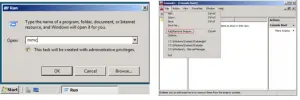

A) Tap start > run> type regsvr32 schmmgmt.dll and then click ok and then ok in the popup box that will appear after this.
B) Again tap start > run> type mmc and then click ok. Click file > click add/remove snap-in.

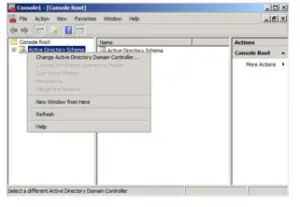

C) To the left below Available Snap-ins, click Active Directory Schema> Add > OK. Right-click Active Directory Schema > Change Active Directory Domain Controller.
D) Click domain controller from the domain controllers list and then click ok.
E) The schema master role holder will get displayed through a pop-up window. Click the schema master holder and click Change. Tap yes to confirm.
