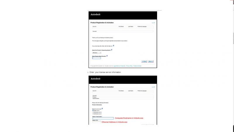

                If you want to make it run then try to start it as "Run as Administrator" most of the times these types of errors are reduce by adapting that method in your software opening. But if you still got any problem then you have to go to your network options and after that you have to set the IP address of the system to the local host that you are using. You can also do that with a software for that you have to download network license manager. After that you have to administration tool and follow the image below.
