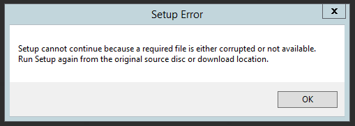

I have a Windows 10 PC, and when our right to install MSI through NAL, I get this error code, 1612. I am not able to install this package, but I require it, so if someone can suggest me ways on how to get rid of this error, it will be useful.

This usually means that your computer failed to locate the source package for installation. It happens when your packages installed on a different drive or that it is corrupt.
This error occurs if your account does not have access rights and permissions to open the source folder. On the NTFS security permission, you need to add your account, and in the Share Permission, add everyone to read. It will enable you to access the package and install it successfully.
Uninstall the previous versions of the same application if you have.
The error can also occur if the installation source path is missing. So make sure that the package is present in the C drive.
