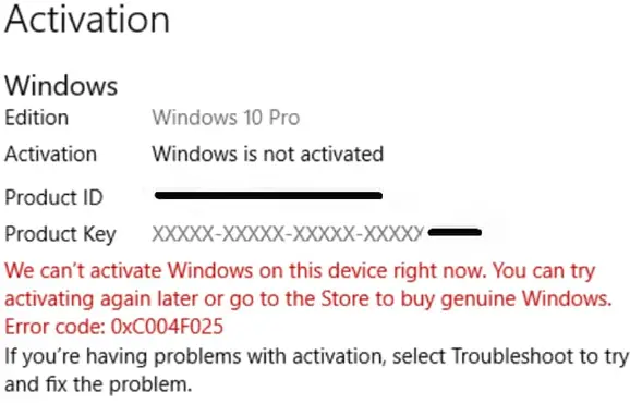

When the user starts receiving the failed OEM activation error 0xc004f025 along with the description message, “We can’t activate Windows on this device right now,” it means that installation of updated patches has been failed. The wrong product key also becomes the reason for the occurrence of this error code. The method to fix the error code is as follows:

Perform Windows 10 activation troubleshooter.
Step 1: Click on the Start button and go to the Settings option.
Step 2: Select Update and Security and then go to the Activation option on the left side.
Step 3: Now, look for the right-hand side and hit the Troubleshooter option.
