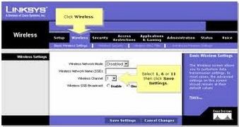

The wireless signal can reach up to 5 bars. Observe how many signal bars or your network, if it did not reach 5 then you may change the channel of your router.
By default, router's channel is set to channel 6. To change the channel up to the maximum channel 11 will definitely broadcast stronger wireless signal.
Log-in to GUI, open your browser and type 192.168.1.1.
  • Log-in to GUI, open your browser and type 192.168.1.1.
  • Log-in using the credentials of your router.
  • Once log-in, click on the wireless tab.
  • Change the channel up to the maximum.
  • Save the changes and refresh the network list.
