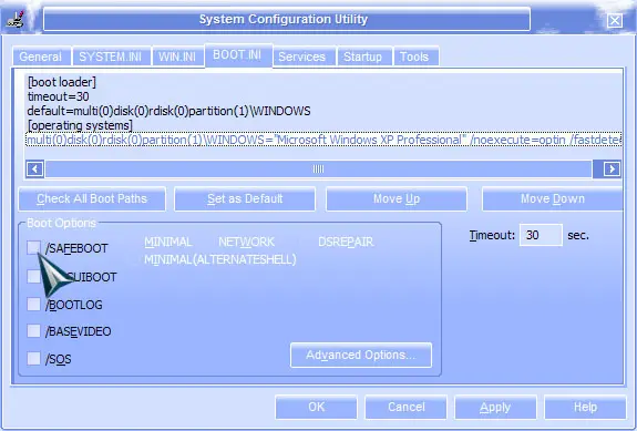

This problem can happen if the “/SAFEBOOT” option is checked in msconfig or the System Configuration Utility. If this option was checked before when you are troubleshooting something and you forgot to disable it, your computer or your operating system will continuously boot in Safe Mode unless you uncheck it.
To check and disable this option, click “Start,” “All Programs,” “Accessories” then right-click “Command Prompt” and select “Run as administrator.” In the command prompt window, type without quotes “msconfig” then hit Enter. In the System Configuration Utility window, select “BOOT.INI” tab and look for the “/SAFEBOOT” option.
/SAFEBOOT option to boot in Safe Mode
If you see this option checked, uncheck it then click “OK.” Restart the computer and see if it boots normally again not in Safe Mode. If this doesn’t work, run “msconfig” again then in “General” tab, select “Normal Startup” then click “OK.” This should fix the problem and boot the computer in normal mode again.
