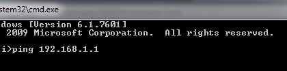

  3. If you have the latest firmware but still there's no activity with the LED lights, try a ping test. On your Vista machine, type cmd in the search field of the Start Menu (pearl Windows). Type ping 192.168.1.1 in the command prompt:
Ethernet cable
You should get Sent =4, Received =4, Lost = 0 <0% loss> as a result. This would indicate that your PC can communicate with the router. Try to access your router's page through your browser and configure your settings.
