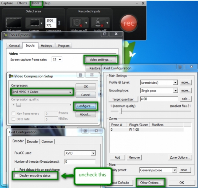

This is an error can occur when using the Xvid or Divex codes as your video compression in Camtasia Recorder. For Xvid you’ll need the Uncheck the “display encoding status” checkbox. For Divx you’ll need to choose the 2080HD profile.
This can occur when recording with any other than TSCC and choosing a dimension that is not a multiple of 4. As a workaround, in Camtasia recorder click on tools, then Options, then Program tab and check the box for the Force region to multiple of 4.

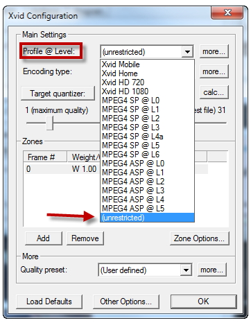

codecs (Xvid include) require dimensions that meet the constraints
Also some codecs (Xvid include) require dimensions that meet the constraints of the encoding profile that’s in use. So it might be helpful to set the encoding profile to unrestricted.
I hope all the information will help you and will solve your problem.
