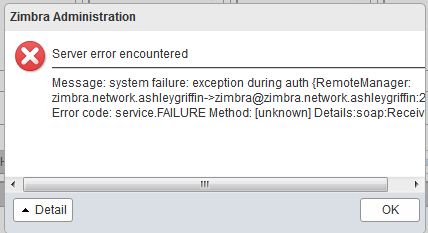

I have this error from Zimbra 8 and I don’t know what this server error is and how can I solve it. Does anyone have a solution for my problem please ? I just updated my Ubuntu, this could be the problem that caused this error ?
Thanks !
Zimbra Administration
Server error encountered.
Message: system failure: exception during auth {RemoteManager:zimbra network.ashleygriffin->[email protected]:2
Error code: service.FAILURE Method: [Unknown] Details:soap:Receiv
Zimbra 8 administration fails to connect with the server
